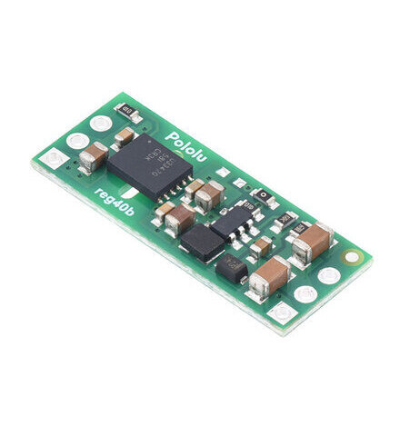

This step-up voltage regulator consists of an isolated DC-to-DC power module in front of a step-up (boost) regulator. This enables up to 100 mA continuous at 12 V out from a 5 V input with full galvanic isolation between the input and output. The 5 V, 300 mA output of the isolation IC is also available.
4.5 V to 5.5 V 12 V 100 mA* 0.4″ × 1.0″
5 V 300 mA*
* Max current per channel when the other channel current is zero.
