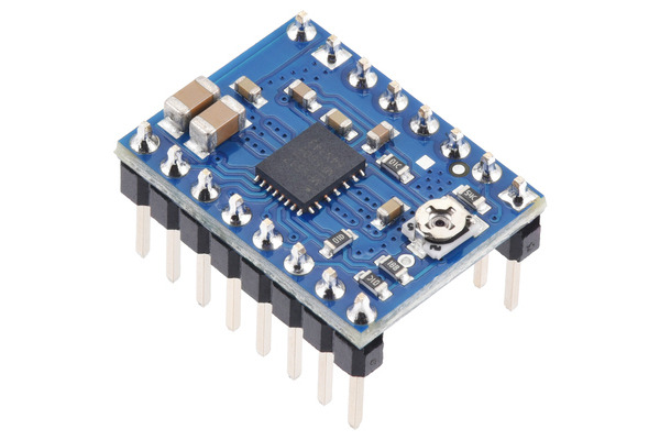

Our stepper motor drivers are specifically designed to drive bipolar stepper motors, which are capable of continuous rotation with precise position control, even without a feedback system. They offer adjustable current control and multiple step resolutions, and they feature built-in translators that allow a stepper motor to be controlled with simple step and direction inputs. These modules are generally basic carrier boards for a variety of stepper motor driver ICs that offer low-level interfaces like inputs for directly initiating each step. An external microcontroller is typically required for generating these low-level signals.
Most of our stepper motor drivers are available in compact (0.6″×0.8″), pin-compatible form factors. The following two tables, organized by increasing operating voltage, compare our selection of these:
![]() STSPIN220 |
![]() DRV8834 |
![]() A4988 (original) |
![]() A4988, Black Ed. |
![]() MP6500, Pot. CC |
![]() MP6500, Digital CC |
![]() MP6602 |
![]() A5984 |
![]() A5984, Blue Ed. |
![]() STSPIN820 |
| Driver chip: | STMicro STSPIN220 |
TI DRV8834 |
Allegro A4988 | MPS MP6500 | MPS MP6200 | Allegro A5984 | STMicro STSPIN820 |
| Min operating voltage: | 1.8 V | 2.5 V | 8 V | 4.5 V | 4.5 V | 8 V | 7 V | |||
| Max operating voltage: | 10 V | 10.8 V | 35 V | 35 V | 35 V | 40 V | 45 V | |||
| Max continuous current per phase:(1) | 1.1 A | 1.5 A | 1 A | 1.2 A | 1.5 A | 4 A(3) | 1 A | 1.2 A | 0.9 A | |
| Peak current per phase:(2) | 1.3 A | 2 A | 2 A | 2.5 A | 2 A | 4 A(3) | 2 A | 1.5 A | ||
| Microstepping down to: | 1/256 | 1/32 | 1/16 | 1/8 | 1/32 | 1/32 | 1/256 | |||
| Board layer count: | 4 | 4 | 2 | 4 | 4 | 4 | 2 | 4 | 4 | |
| Special features: | low input voltage |
low input voltage |
digital current control |
SPI control, stall detect, auto hold, unipolar mode |
versions also available with fixed current limits |
| Available with headers soldered?: | Yes | Yes | Yes | Yes | Yes | Yes | Yes | Yes | Yes | Yes |
| 1-piece price: | $10.95 | $9.95 | $8.95 | $9.95 | $9.95 | $9.95 | $14.95 | $5.75 | $5.95 | $18.95 |
| 1 On Pololu carrier board, at room temperature, and without additional cooling. 2 Maximum theoretical current based on components on the board (additional cooling required). 3 This is the maximum current limit of the IC, and it results in 2.8 A through both coils in full step mode or up to 4 A through a single coil when microstepping. |
