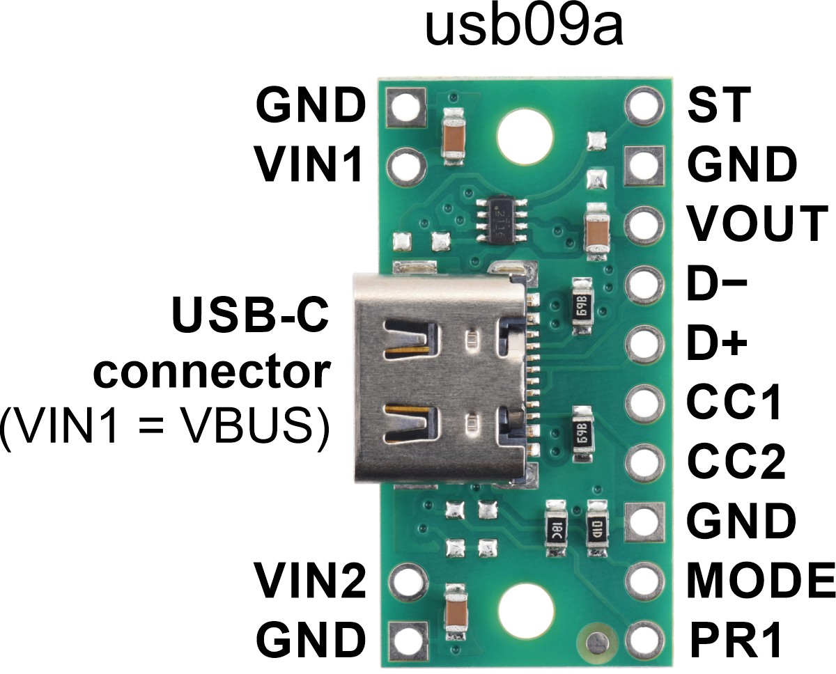

Pinout of the TPS2116 Power Multiplexer Carrier with USB Type-C Connector (USB priority).

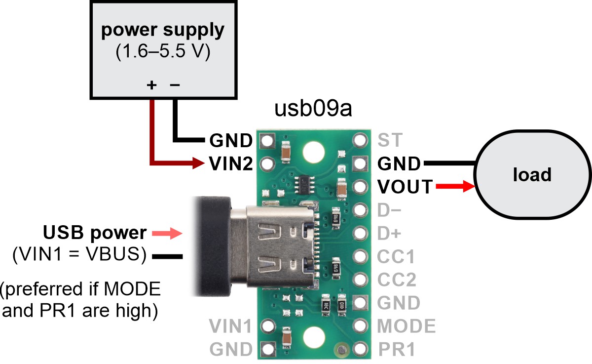

Typical connection diagram for using a TPS2116 power multiplexer carrier (usb09a) with USB as the preferred supply in priority mode.
