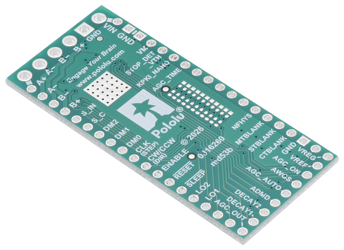

TB67S579FTG Stepper Motor Driver Carrier – Full Breakout, bottom view.

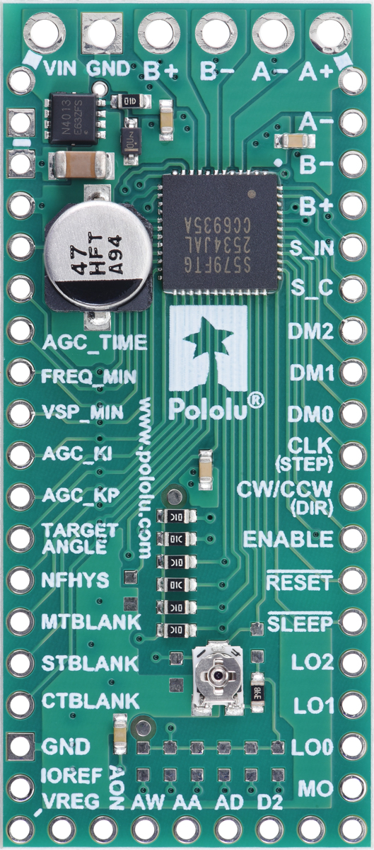

TB67S579FTG Stepper Motor Driver Carrier – Full Breakout, top view.

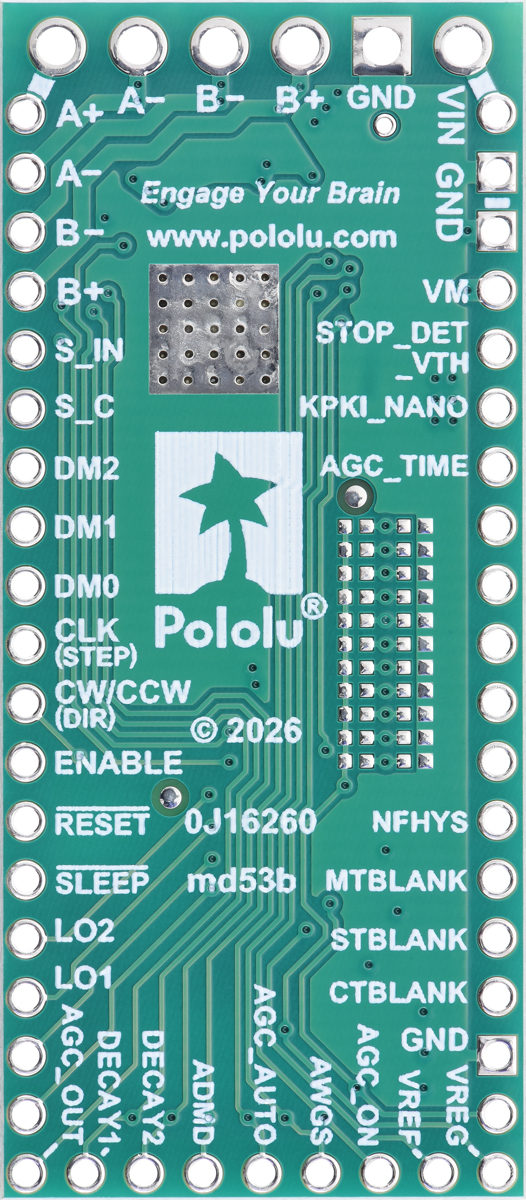

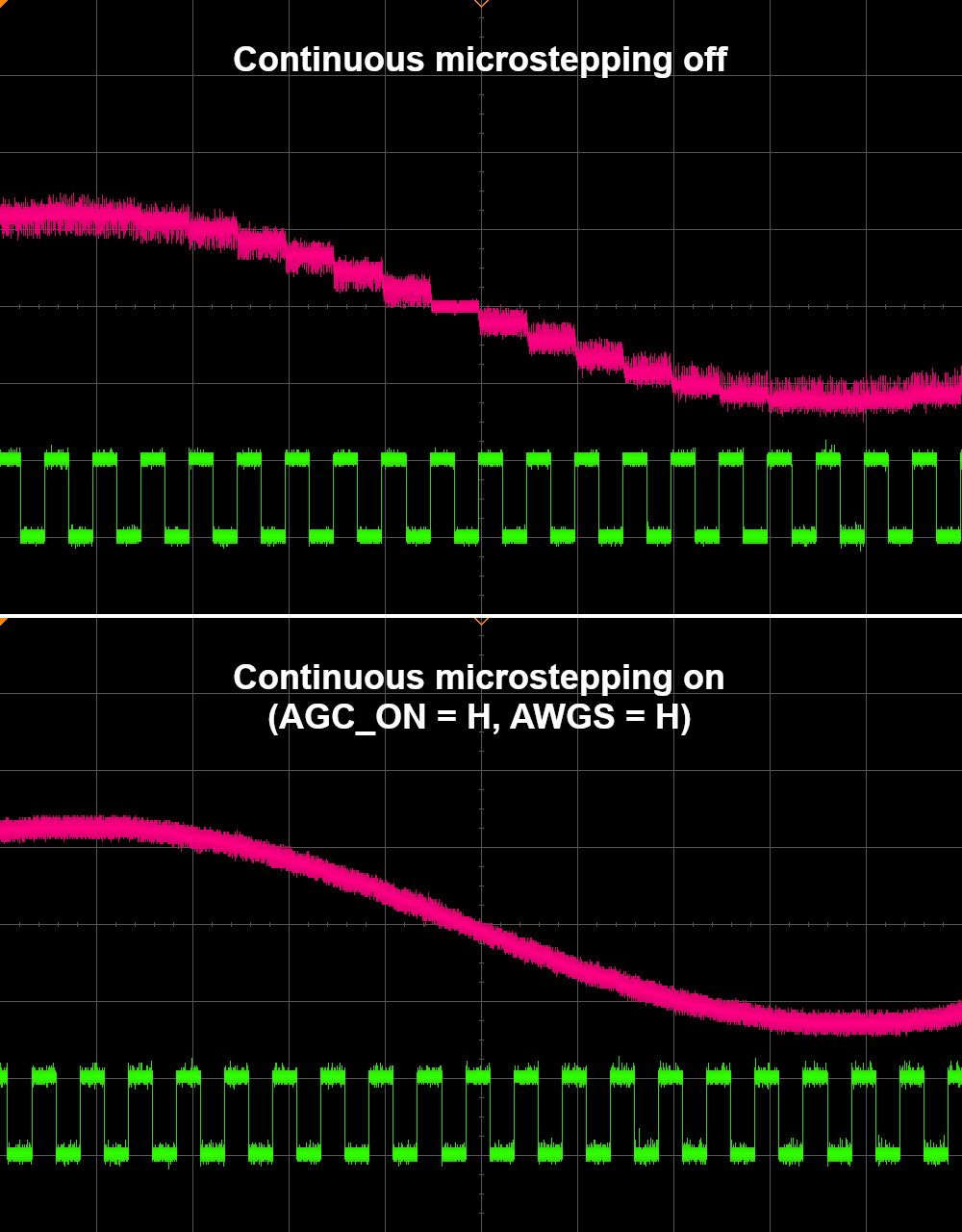

Stepper motor current waveforms from a TB67S579FTG driver in 1/8-step mode with continuous microstepping off and on.
