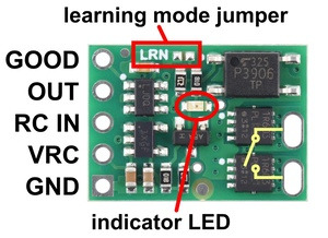

Pinout of the Pololu RC Switch with Isolated Solid State Relay/Switch, SPST.
For the Pololu RC Switch with Isolated Solid State Relay, the learning mode jumper consists of a pair of exposed pads on the component side of the board labeled “LRN”. To connect the two pads, you can use a wire, screwdriver, or some other conductive tool.
