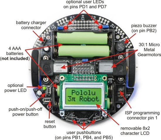

General features of the Pololu 3pi robot, top view.

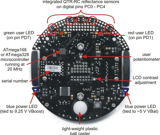

Labeled bottom view of the Pololu 3pi robot.
