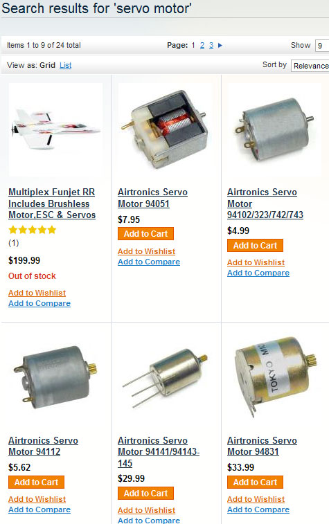

Getting back to the basic terminology, we usually just call these objects servos, and we might initially say “RC servo” or “hobby servo” to make sure everyone understands that we’re in the general domain of servos developed for the radio control hobby industry. Within this context, these devices are always called servos, not servo motors. You should not just take my word for it: at a major hobby store like Tower Hobbies, a search for servo motor yields three results, none of them the hundreds or thousands of servos shown when the search is just for “servo”. At Hobby Lobby, a search for “servo” yields over 500 items; a search for “servo motor” returns fewer than 200, and even those show up only because the motor in the servo is discussed in the product description. A similar search at Hobby People, a site that has physical stores in Las Vegas and southern California, shows 24 results, almost all replacement motors for servos:
Hobby People search results for “servo motor”.
Similarly, name-brand servo manufacturers like Futaba, Hitec, JR, and Airtronics all refer to their products exclusively as “servos”. RC servos tend to be called “servo motors” only by relatively small organizations or in projects or tutorials made by people that perhaps do not actually know servos that well (or who want the term “motor” to also appear on their web pages for search engine optimization purposes).
