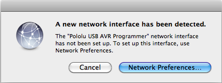

Note: If you have OS X 10.7 (Lion) or later, you don’t need to change your programmer’s firmware. The modified firmware only allows programming of AVRs; it does not support the bonus features of the programmer (the TTL-level serial port and the SLO-scope). Checking the installationTo check the installation, plug the Pololu USB AVR Programmer into a USB port on your Mac. Click “Cancel” if you see the following dialog:

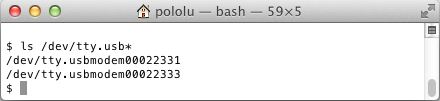

In a Terminal window, type
If you are using Mac OS X 10.7 or later and have not changed the programmer’s firmware, there should be two new If you are using an older version of Mac OS X, you will need to install the modified firmware as described above, and you should only see one new |
