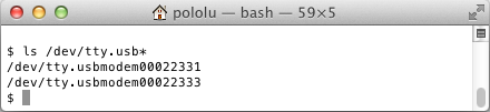

In a Terminal window, type
The entry with the lowest number is the programming port, and later you will need to pass its name as a parameter to AVRDUDE. |
