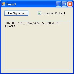

Sample C# TReX program: running the program.
The following program, written using Visual C# 2008, provides a simple example of how you can send and receive data from the TReX or TReX Jr using Microsoft’s visual C# and your computer’s serial port. It sends the TReX a “get signature” command when the Get Signature button is pressed and displays the response from the TReX in the text box.
The sendCommandPacket method is a simplified version of the one used by the TReX Configurator utility (297k zip).

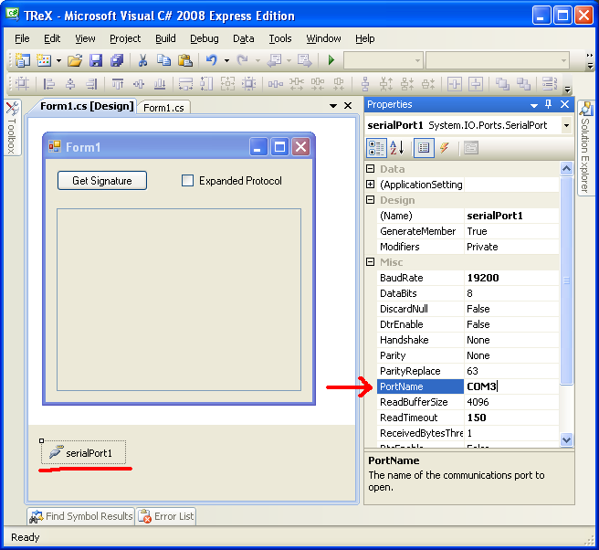

You can download the project files here: trex.zip (60k zip). Don’t forget to configure the serialPort1 object’s portName property for the COM port to which your TReX or TReX Jr is connected.
Sample C# TReX program: configuring the SerialPort object.
